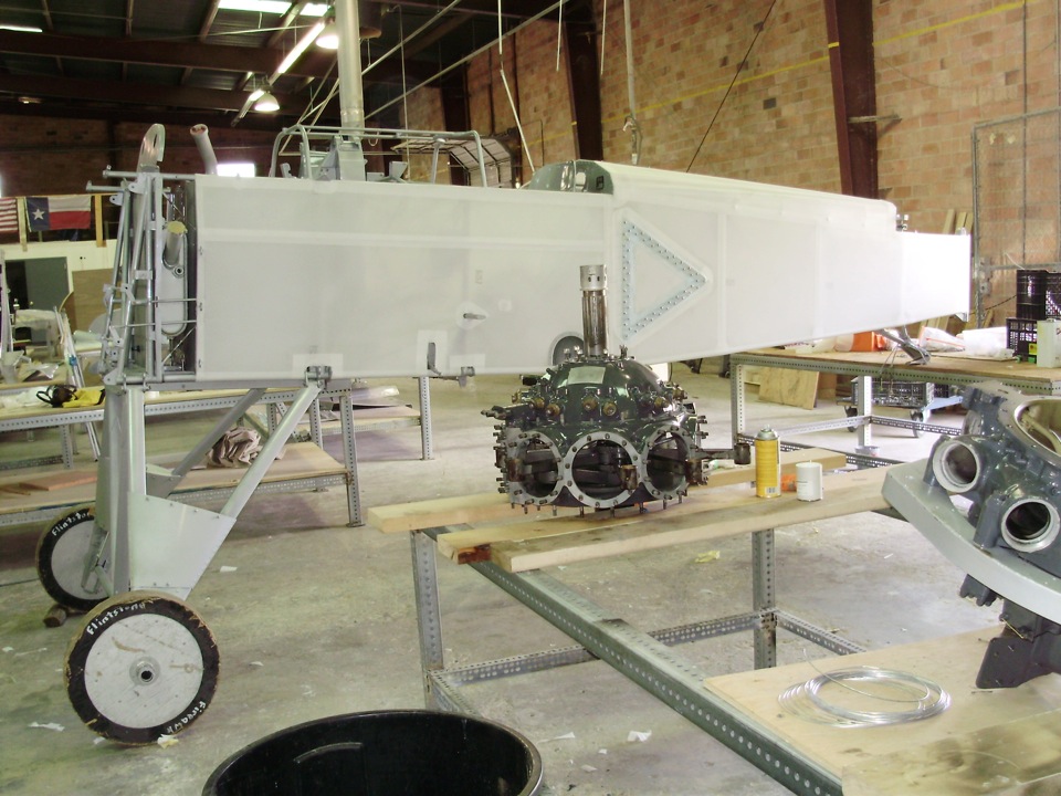

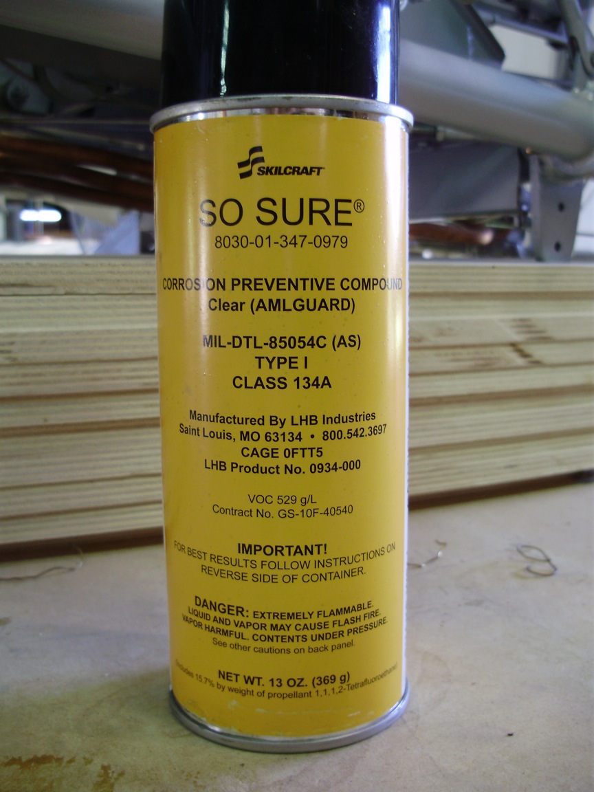

I finally found the magic preservative so many tribesmen have been searching for! The name is "Amyl Guard" or also called "So Sure". The product is sort of alcohol based - the actual solution is TOXIC and Explosive.
You spray on two coats and it penetrates very well, and dries to a dry film which does not attract sand etcetera. We had to put this stuff on the bare metal parts of the Curtiss F6 as part of the contract.
The bad news is that it is $45 per spray can and minimum order was three cans.
