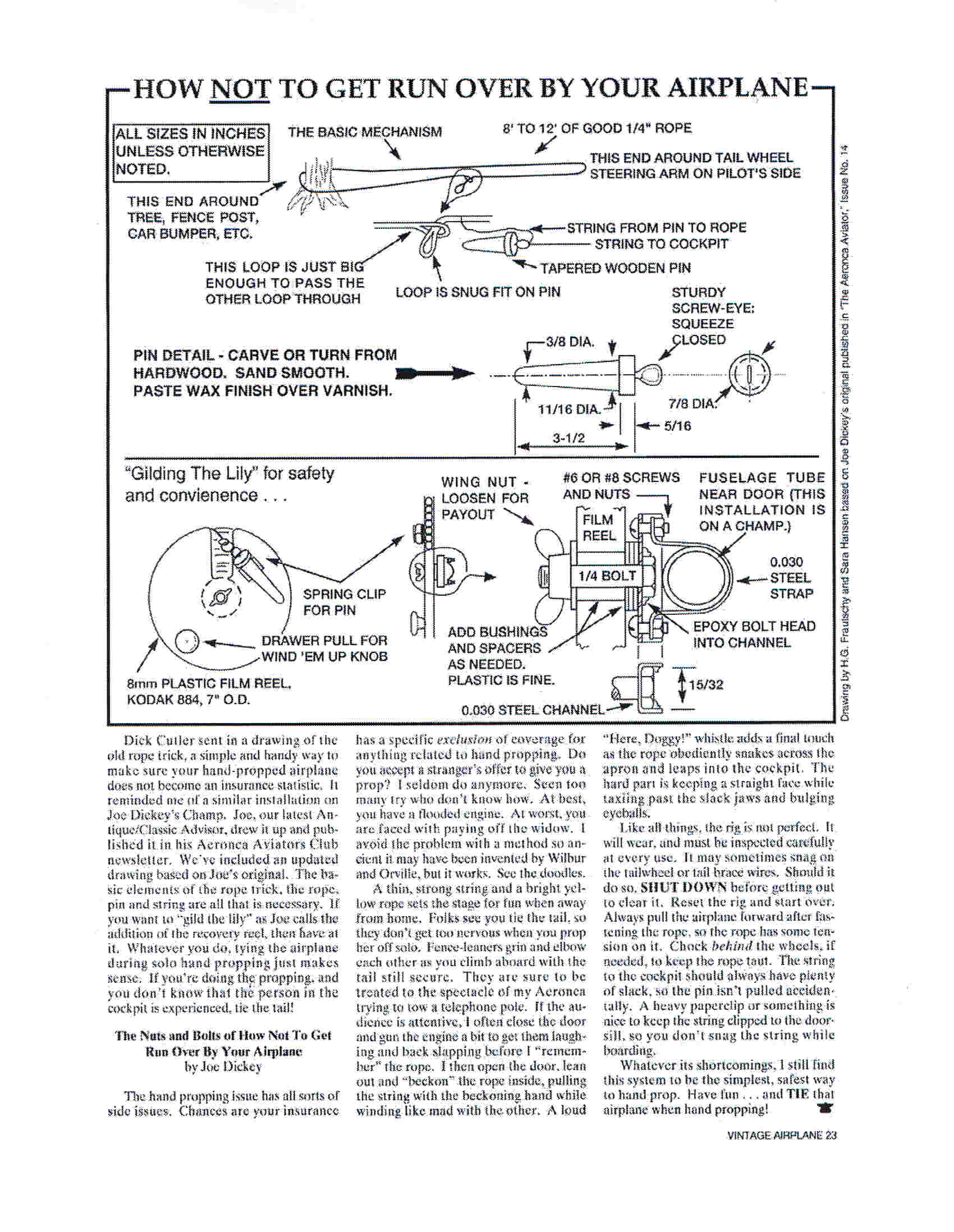

                            Here is a quick and simple way to do it. Don't need a $40.00 snap shackle and everything was available in 1941. From Vintage Aircraft.
                            Ron Greene
                            TF#360

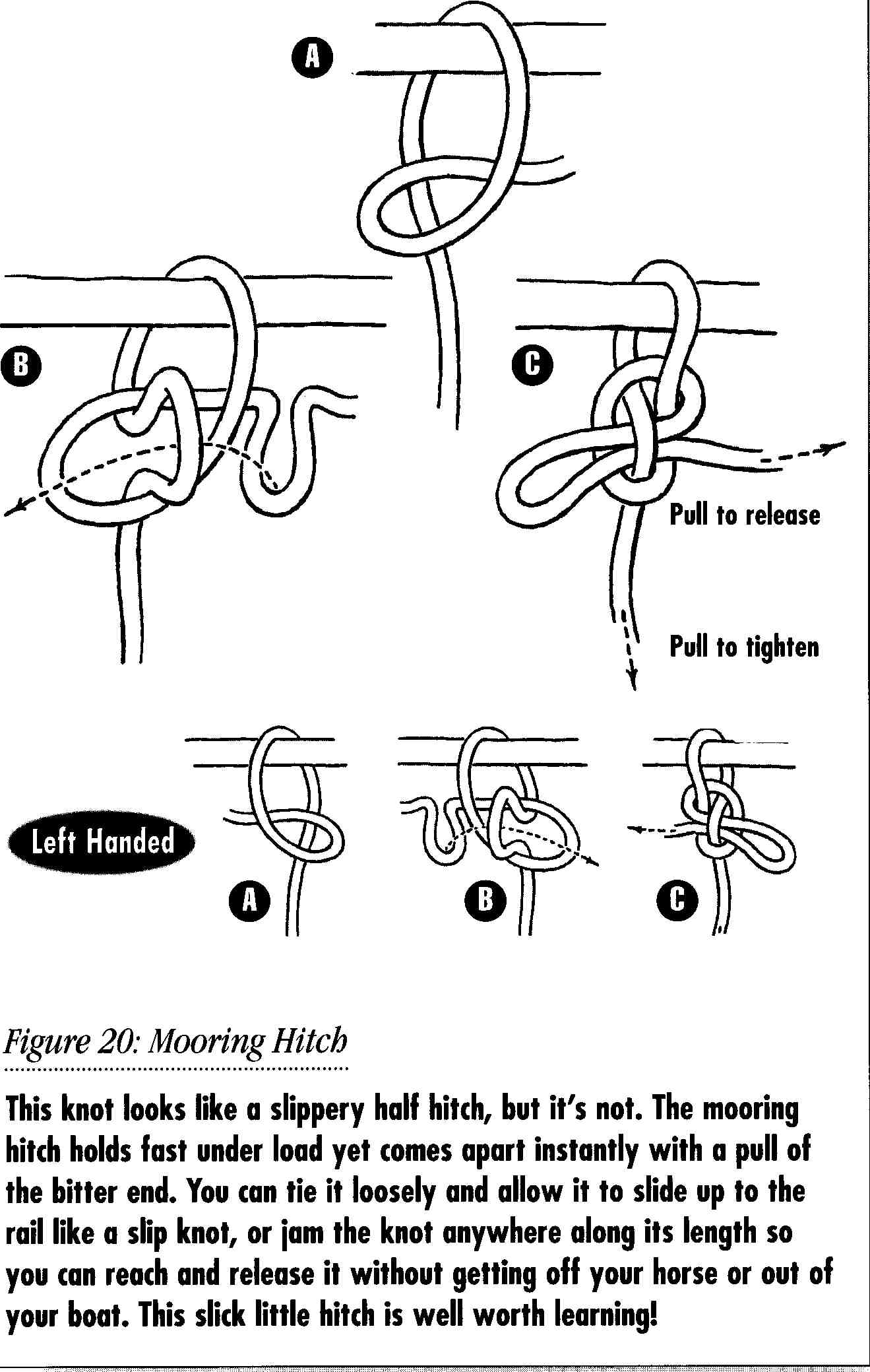

                              Even simpler way to do it, taking the rope away with you:
                              One long piece of rope, long enough to reach from your struts on one side of the fuselage, back past the tail and around a fencepost, then up to the struts on the other side of the fuselage. Tie the rope around the struts with a mooring hitch at each end.
                              Start the engine, climb in the cockpit. Lean out the right door, tug the free end of the rope to un-tie that mooring hitch. Lean out the left door, un-tie that mooring hitch, and wind in the rope through the left door. Stow the coiled rope in the baggage compartment.
                              (I can't take credit for this -- someone else posted it on a handpropping thread here a while back. Attached scan is from Cliff Jacobson's "Knots for the Outdoors.")
