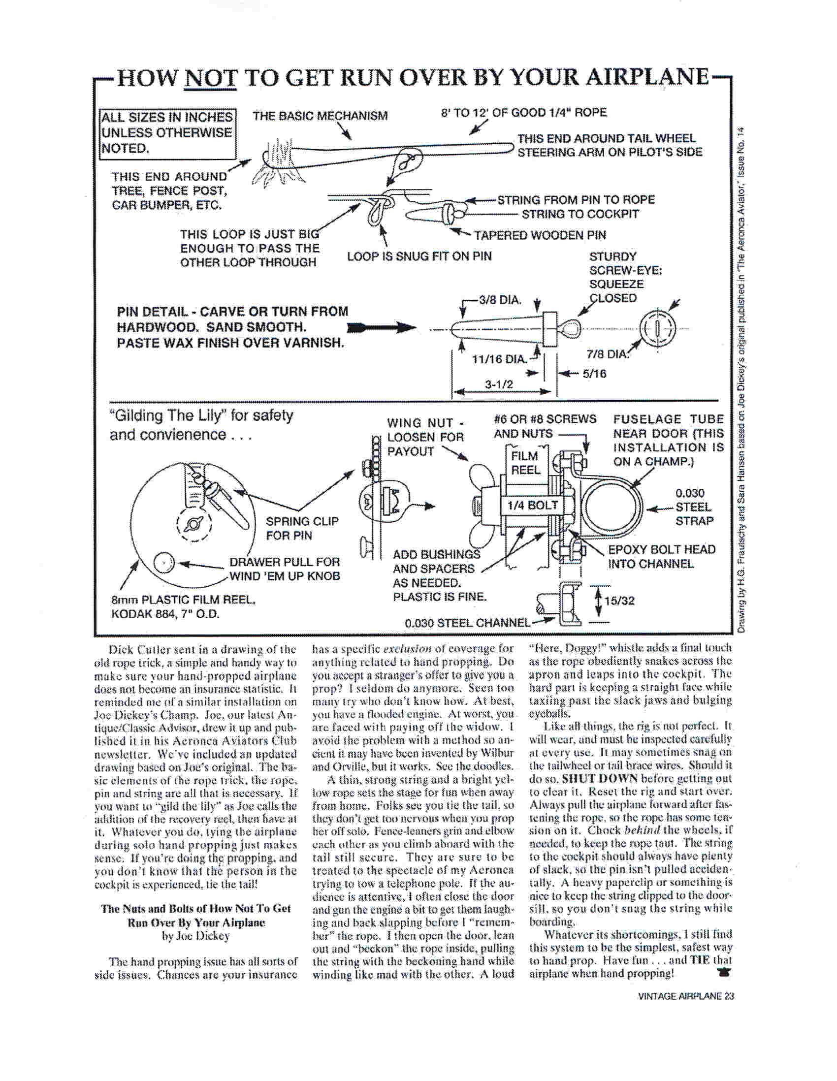

    Does anyone have one of those sailplane/towhook/release thingies tied to a rope that connects to the tailwheel and hold the handprop plane until you climb in and release it from the tie down from inside the cockpit. Sorry for the insanely long description but I don't recall the monicker. Anyway, If you have one and want to sell it, let me know. If you think you can build one for me, give me a bid. I'd like to get one of these things quite soon.

    Seems like a good idea. Try http://www.wingsandwheels.com/page30.htm
    Would it require a STC on a T-Craft?

      Here is a simple way.
