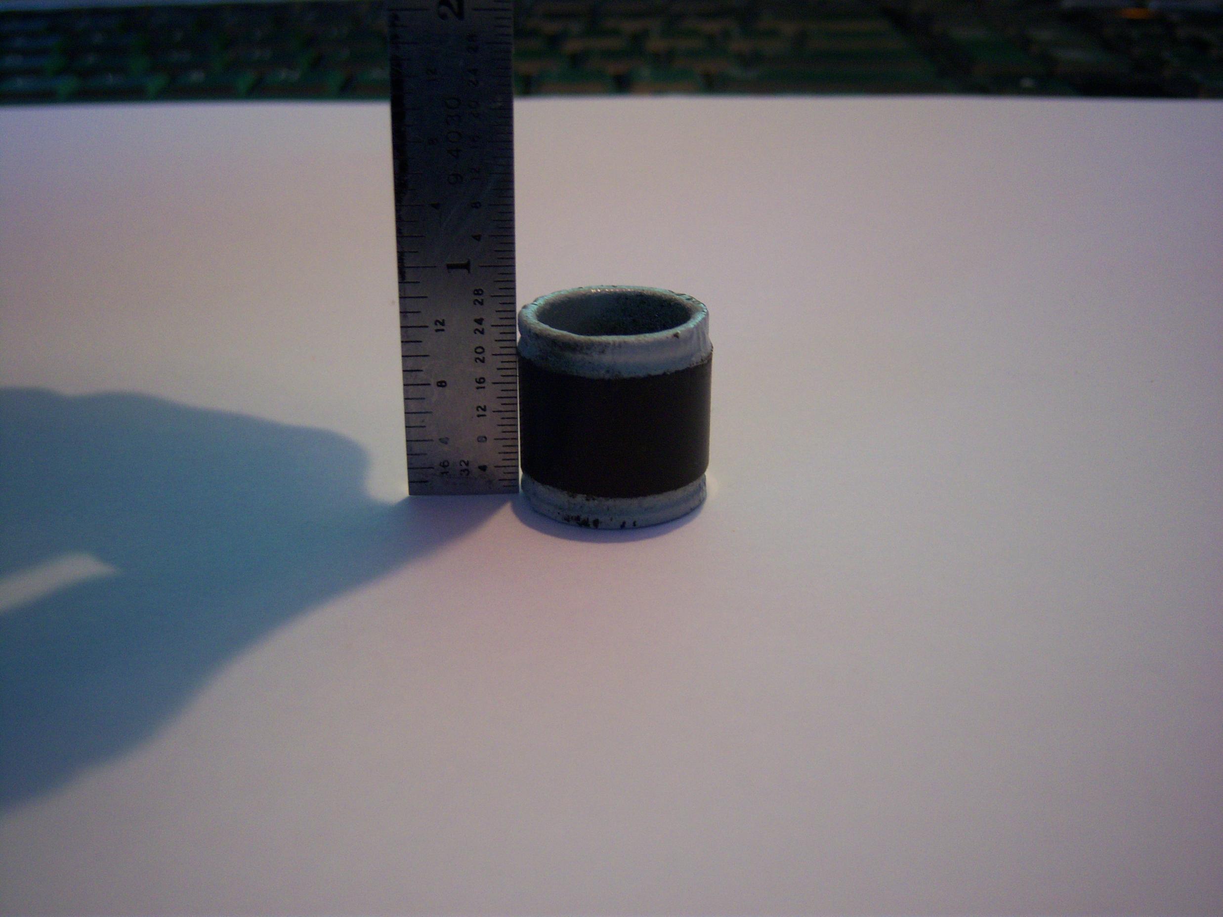

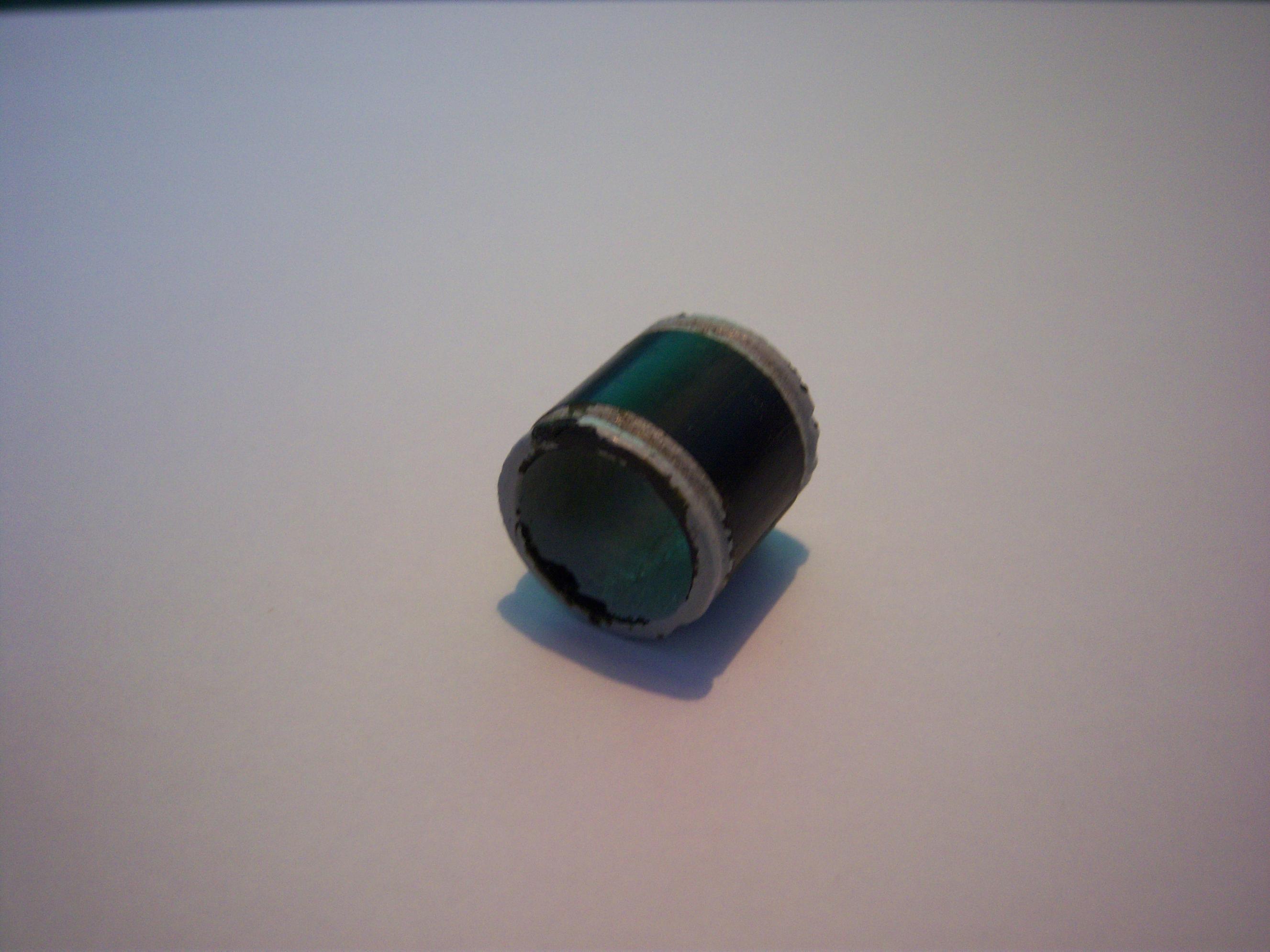

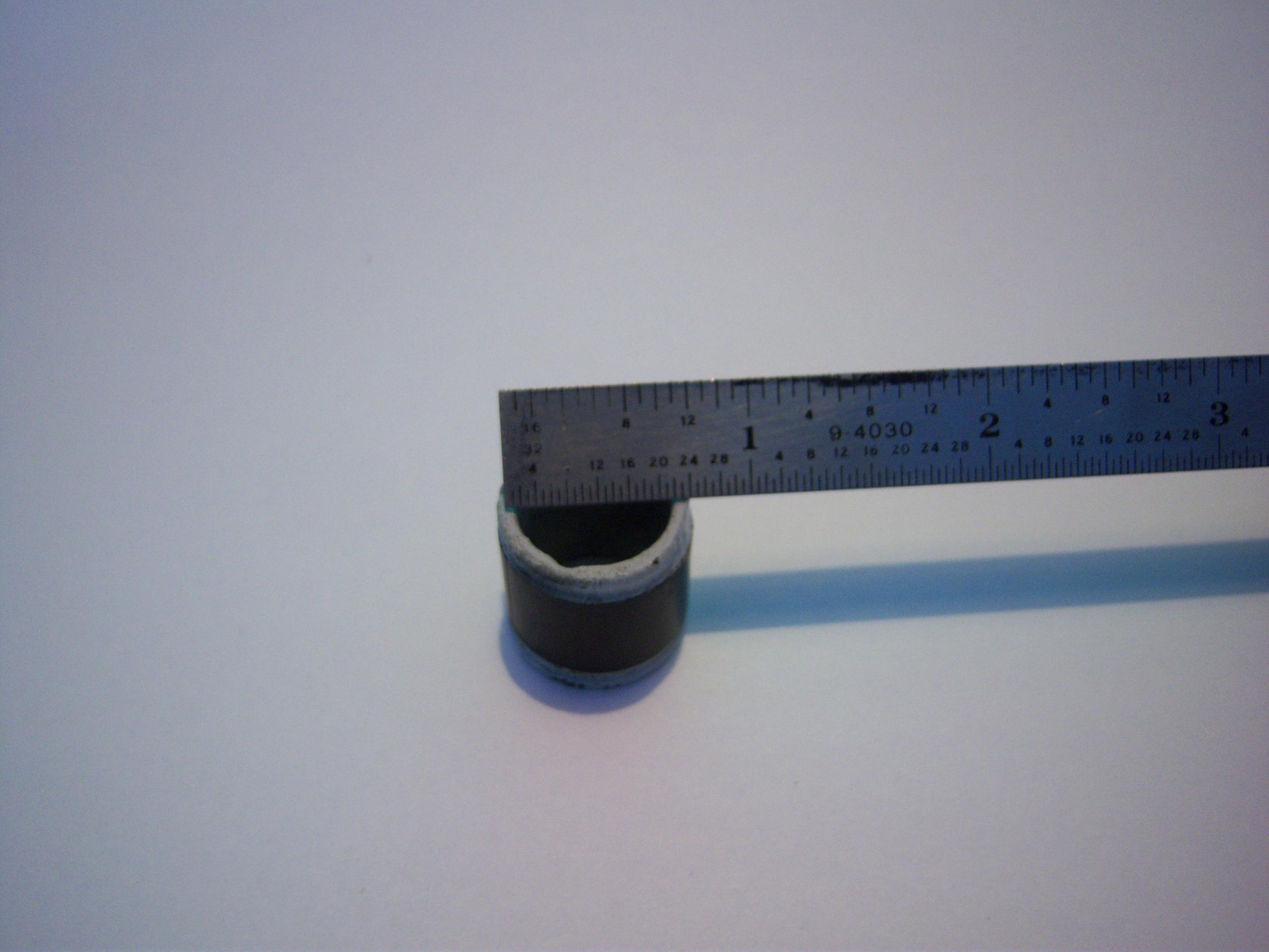

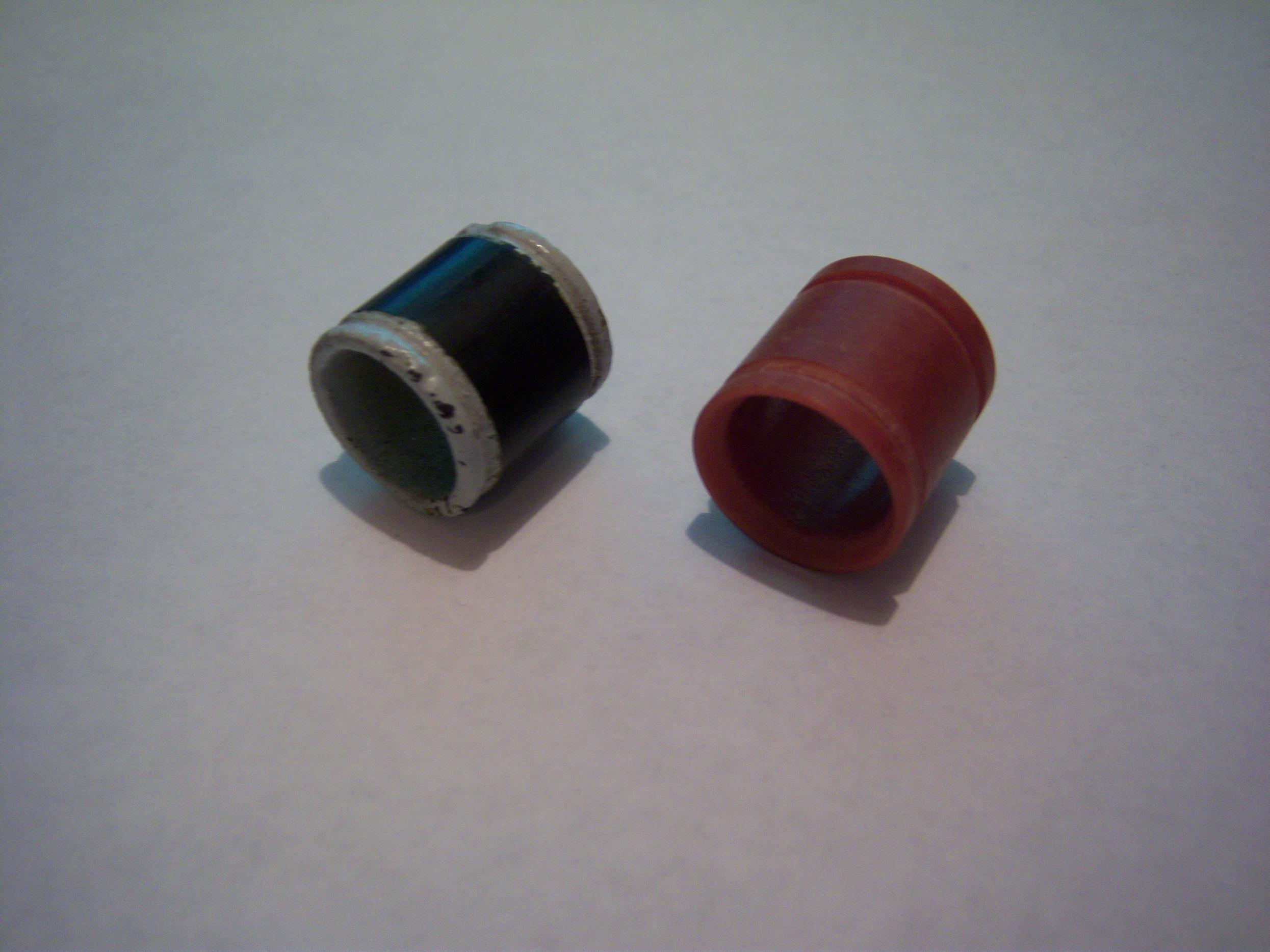

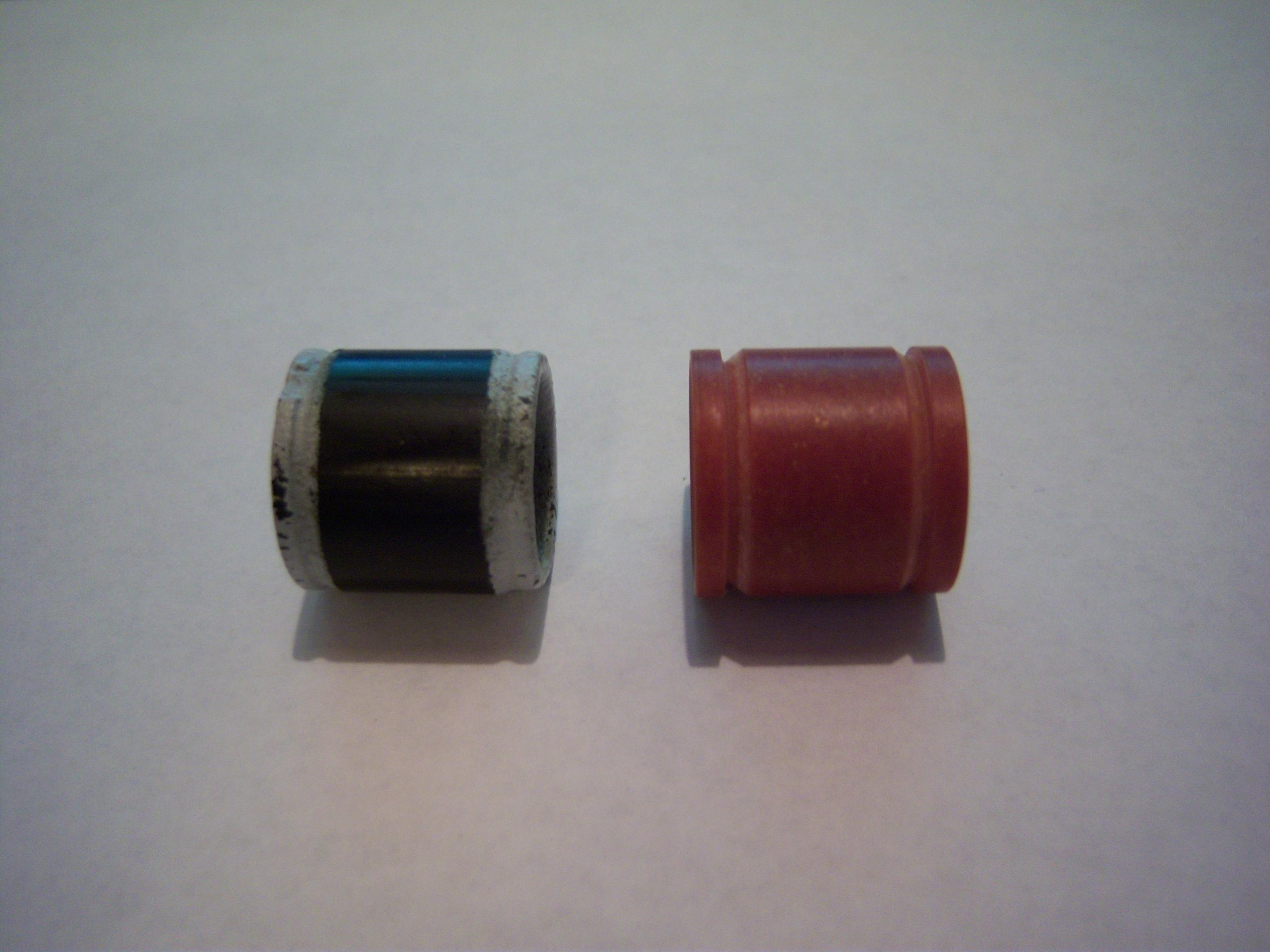

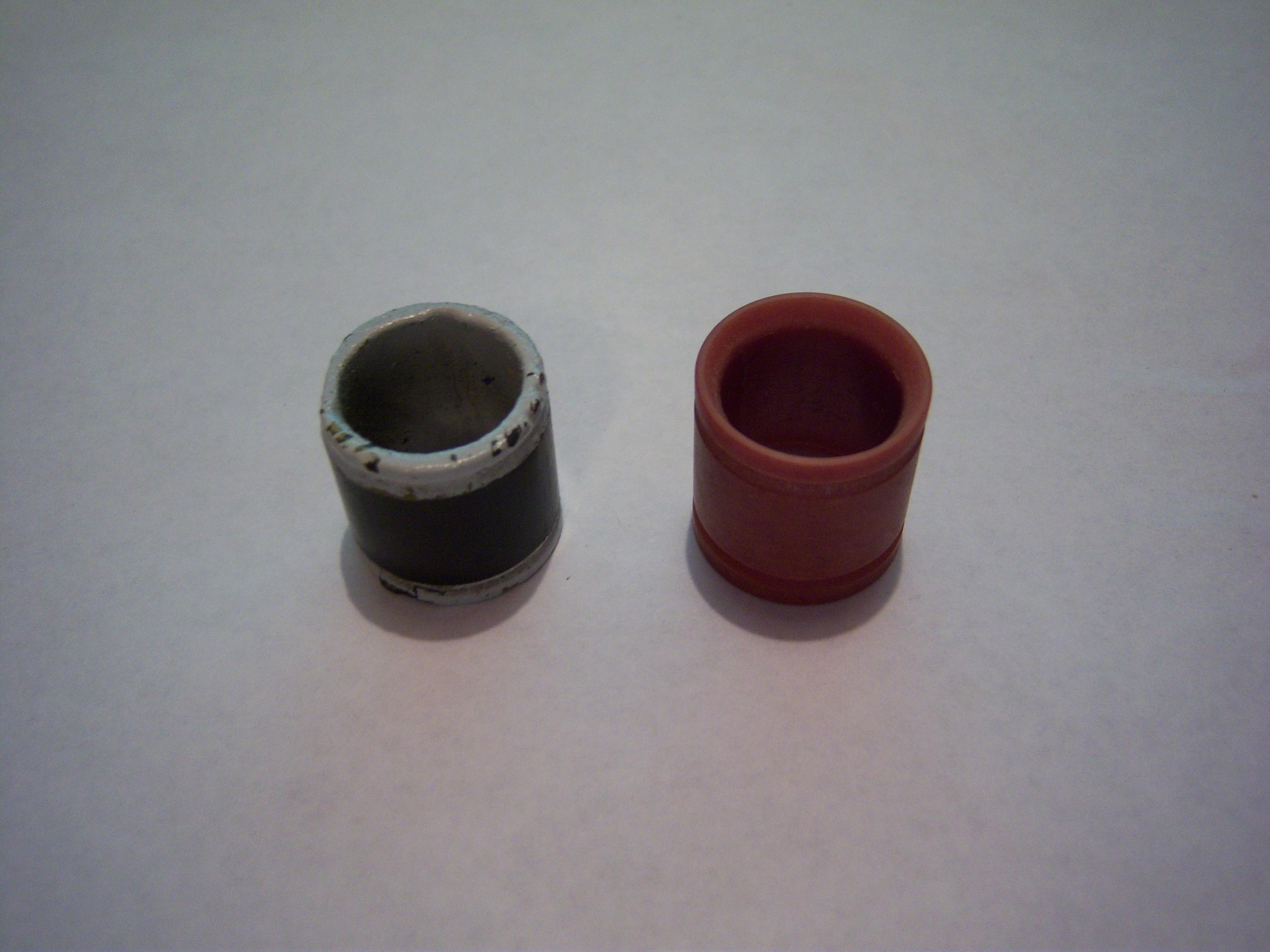

Does anyone have a few Bake-o-lite fairleads they would like to sell? I need six good used or new fairleads. Attached are some pictures of what i am looking for.

This is 5/8 OD phenolic with a 3/32 wall thickness which is identical to the OEM phenolic stock in every way except color. New stuff is tan vs brown.
Cut the phenolic tubing to length with a band saw, a hack saw or turn it on a lathe if you have one. Square the tubing on a bench sander if your hacksaw skills are like mine. Fairlead length is .837 inches. Allow extra if you plan to sand it square.
Now chuck a 5/8 dowel into your drill press and slip one piece of phenolic tubing onto the dowel. Turn the phenolic on the dowel and cut the groove into each end of the fairlead using a needle file or a small sharp tool of your choice. DON"T FORGET TO WEAR EYE PROTECTION. If the phenolic slips, just use a little duct tape to hold it to the dowel.
