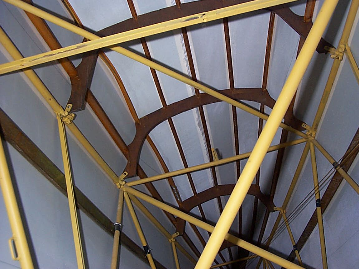

    Hi Dan, This photo tells a lot about your ship !! The turtledeck conversion was done using the Taylorcraft kit. You can tell this by the way the formers were attached to the top longerons and also the vertical brace going from the top to the bottom longerons. See you tomorrow. Dick

      Dick his ship was Don Shinglers "Chipmunk" and has made many of our Fly-Ins. Yes it is one of the very original conversions back to the straight back.....
        Converison
        Logs show done in 1951
