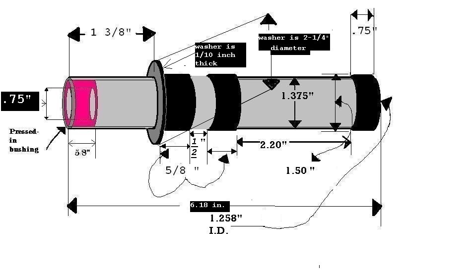

This is an old sujbmission that I tried to make a bit easier to interpret. It is intended to depict the measurements from my ski bushing, which fits a BC-12D tapered axle.Attached FilesLast edited by Dick Smith; 04-27-2020, 19:13.Dick Smith N5207M TF#159
