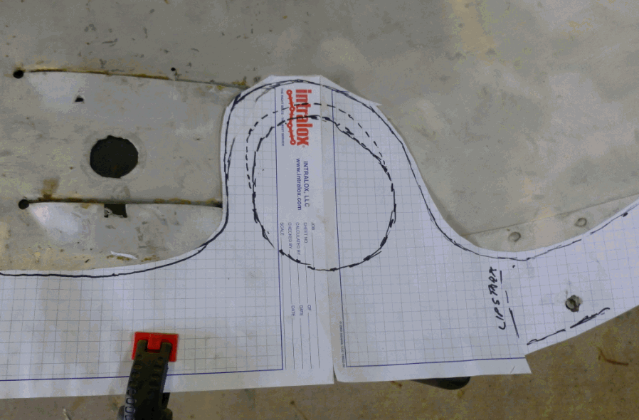

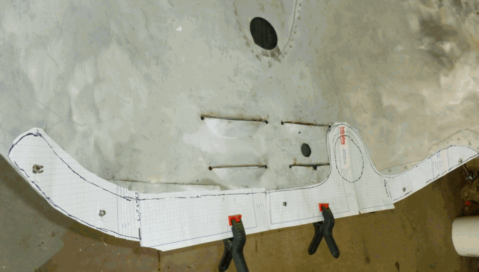

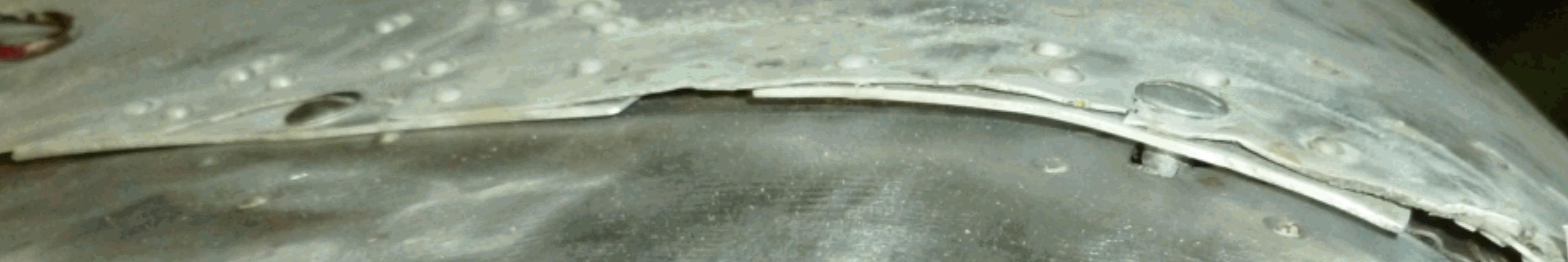

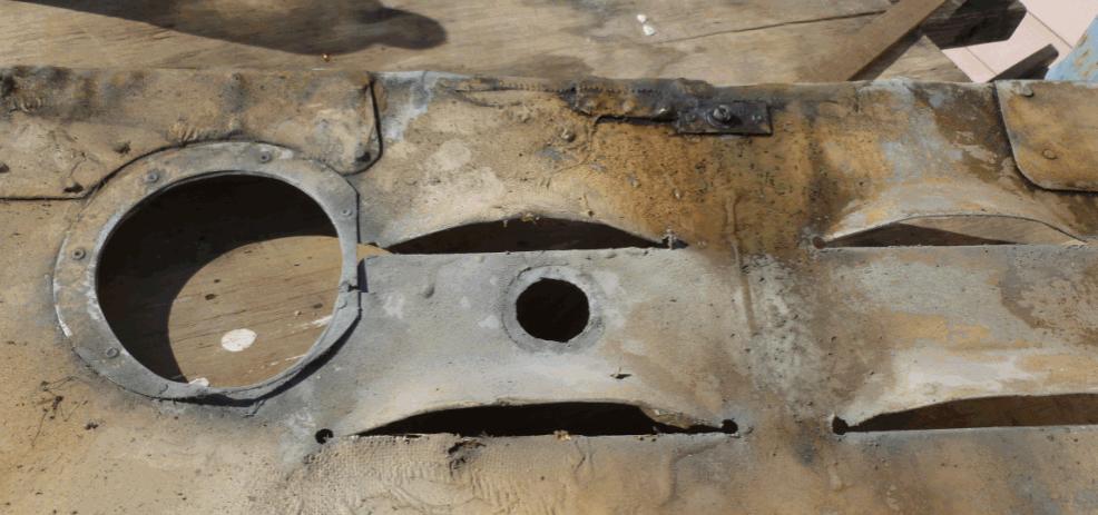

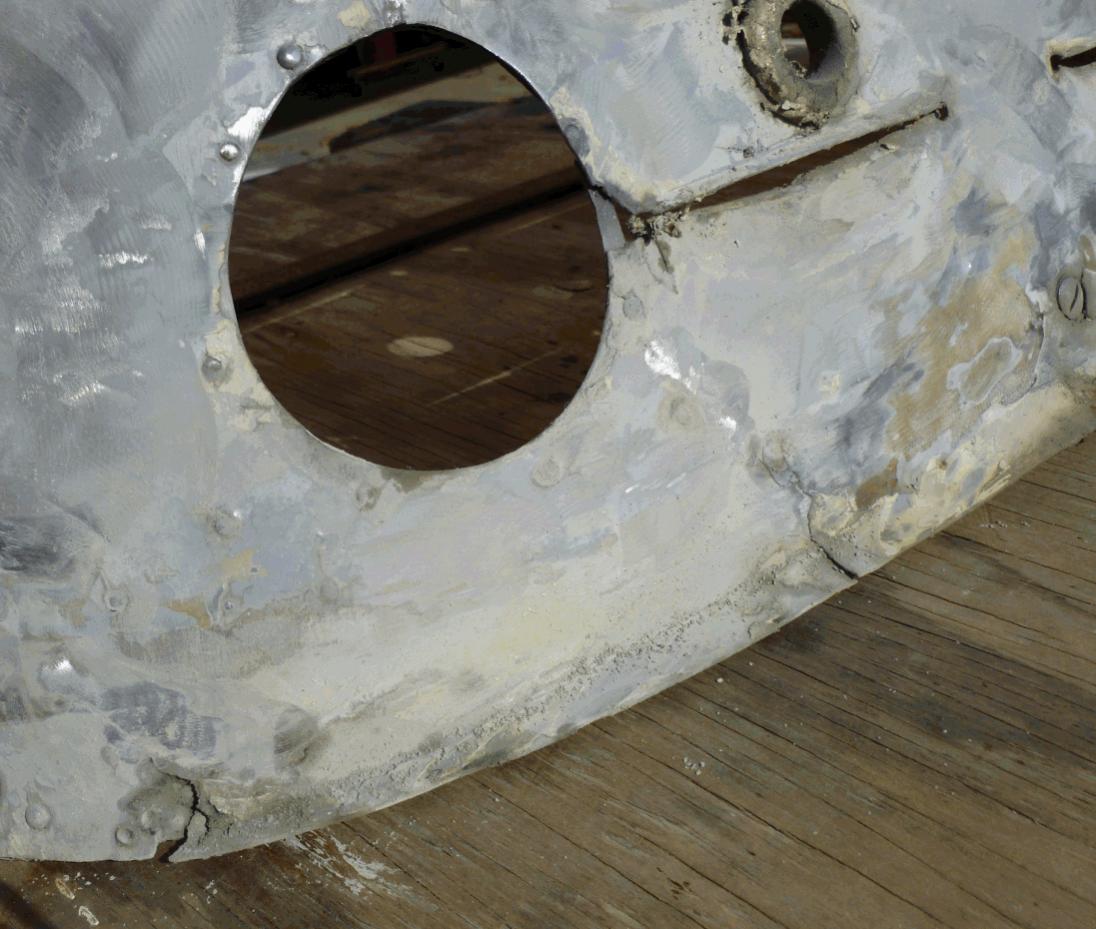

    I have about 5 patches that reinforce cracks from the trailing edge of the lower engine cowl of my '46 BC-12D.
    And I have 2 new cracks that are unrepaired.
    I'm planning to remove all of the existing individual patches and make one long reinforcing strip out of 0.040" 6061 aluminum.

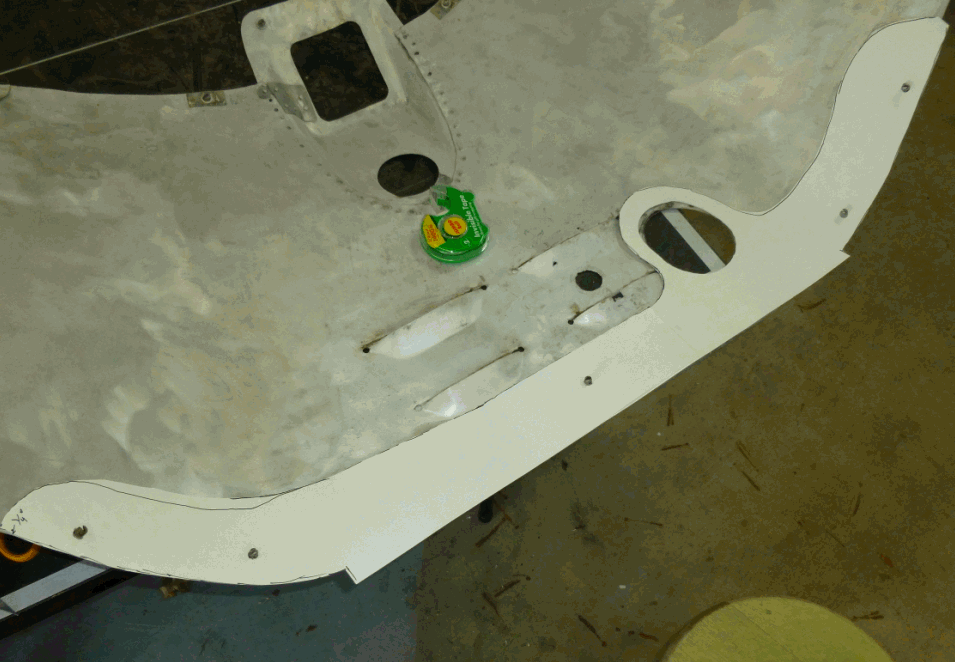

    You can see from the template pictures below that the exhaust hole will be included.
    Any pitfalls to doing this?
    Before I drill any holes in the patch, I plan to fixture the cowl in its installed position (more curved than shown).
    I'll replace all the Dzus fasteners.
    Also, my exhaust muff was rubbing up against the edge of the hole in the cowling. So the dashed line shows where I plan to make the new opening to allow a little clearance.

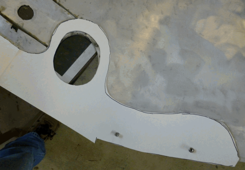

    Here's my next iteration of template. I used thicker paper to make sure that it was laying right. And made it a touch wider in spots.

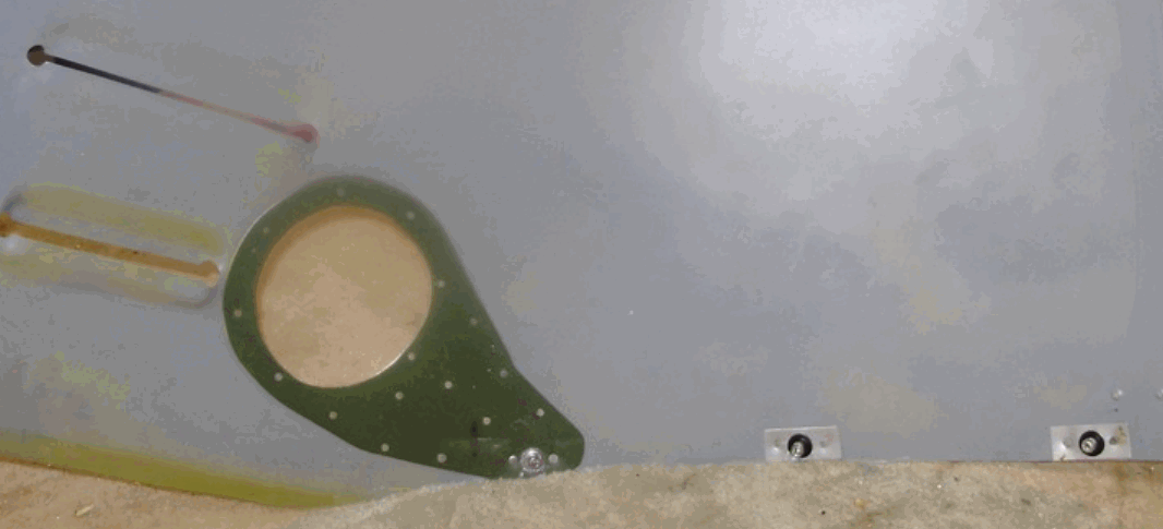

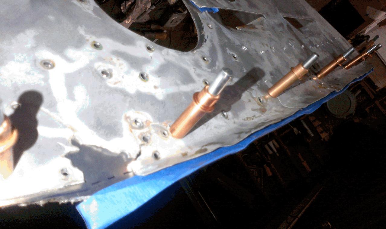

        That's good stuff to consider. I think that the picture below roughly describes one of your comments. This picture is not mine. I saw it somewhere else on this site.

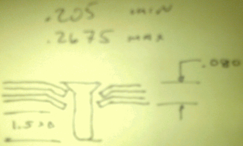

        My intention was also to use flush rivets and dimple both pieces of aluminum (kind of like the crude sketch below). The outer piece is the existing lower engine cowl and the inner piece is the new patch/doubler.
        But I see your point about doing this near the trailing edge where it overlaps the boot cowl (the rivet bucktails might gouge the boot cowl).
        Let me go back and look at my existing patches and my boot cowl and see if I can see a way through this. If I use double-countersunk rivets (which I had never heard of previously), I would countersink instead of dimpling and the rivet would be flush on both the inside and the outside, right?.

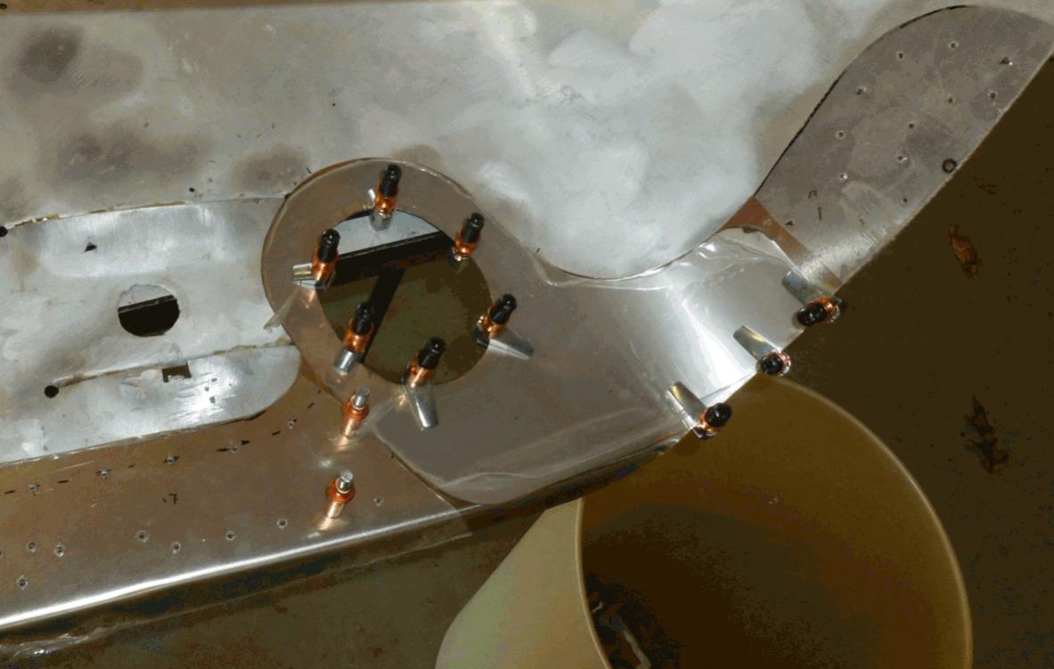

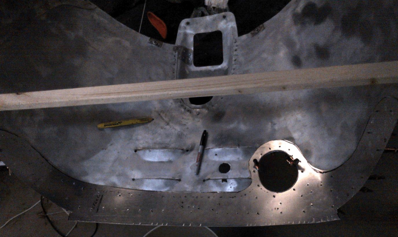

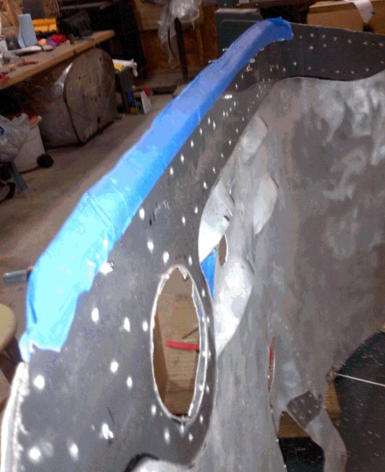

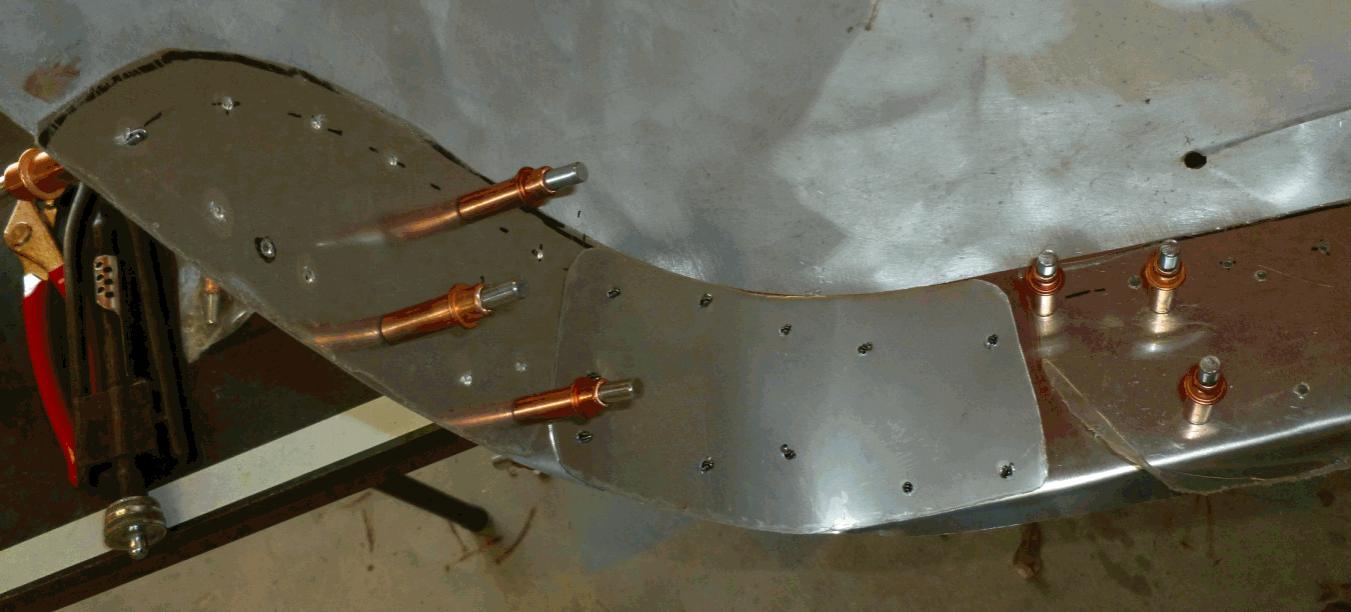

          Below are some picture of my aluminum cowl doubler. I checked the fit of the lower engine cowl to the boot cowl. Having rivet bucktails did not seem to be a big deal at all. It looks like there is a little room. And where the rivet would touch is actually against the steel flange of the firewall. Since I've had rivets in this area for decades, I checked the firewall flange to see if there were any signs of rubbing or wear. But I couldn't find any.
          So I don't plan to double-countersink the rivets.
          Tim Hicks
          N96872
            Re: Lower Engine Cowl Reinforcement
            Tim,
            That looks nice!
