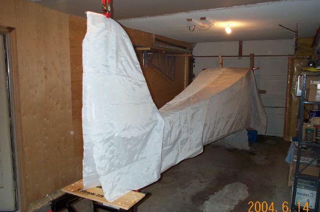

        Well, I will be able to add my two cents in about a week. I am using an envelope and just streched it over the fuselage tonight. So far so good. Couldn't get much simpler. I am going to glue things down on the weekend, then start shrinking. I will let everyone know how it turns out.

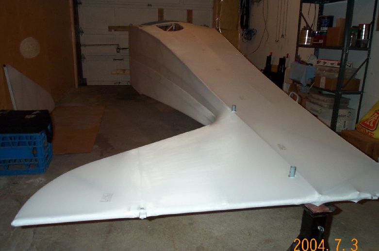

            Well I have now finished the fuselage and it is ready for the first brush coat of Poly-Brush. This is the first thing I have ever covered so I can't comment on the blanket method versus the envelope method. But I can say that the envelope method sure seemed to work good.
            I have added some more pictures of my rebuild on the gallery (CFXSU rebuild). Hope to meet many of you in Alliance next weekend.
