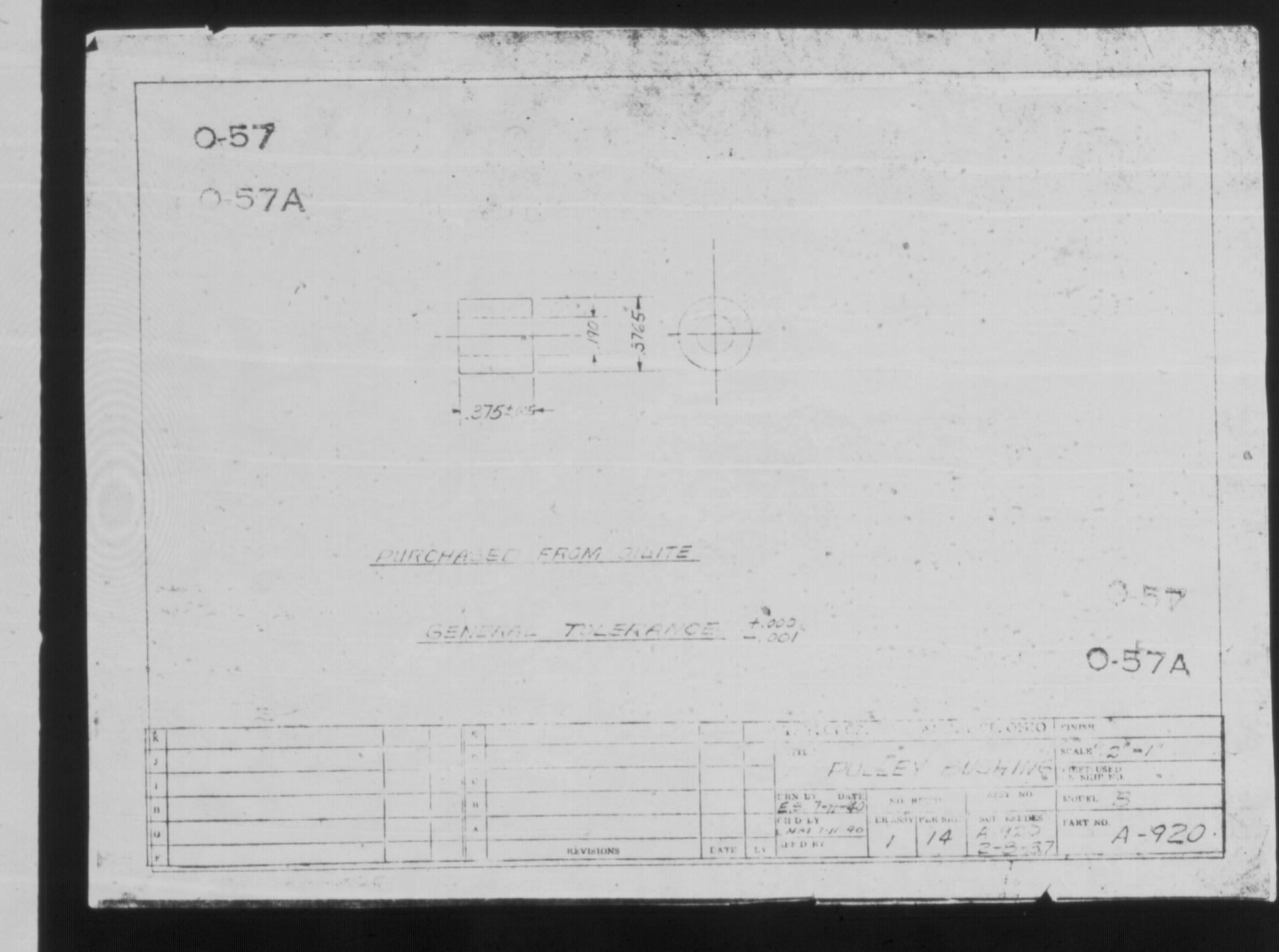

In Univair's copy of the BC12D service manual the drawing on page 3 calls for a number of AN920 bushings. I think they are used in the cable ends. I cannot find this AN number in my Mechanics Handbook. Anyone know what they are? Thanks, Larry
AN920 bushing
Re: AN920 bushing
I believe they are the bronze bushings that go in the center of the pulleys for the AN3 bolt to go thru.Last edited by Buell Powell; 08-12-2009, 20:01.Buell Powell TF#476
