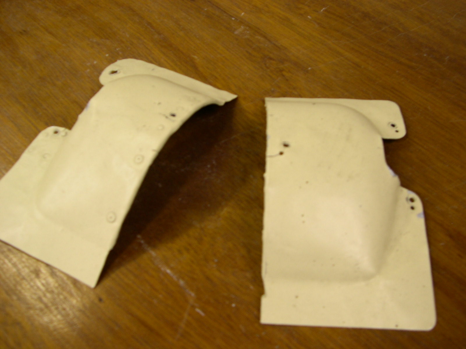

      One question (off the topic of this thread, sorry): What's that slot for on your bungee covers? My bungee covers don't have that. Do I need a slot?

        Hi Bob, Glad you enjoyed that! I should put some more stuff up there when I get the chance.:hammer:
        The slots were in the bungee covers when I got them. My guess is, that someone figured that the safety cables were awkward all tucked up around the bungees so pulled them through the slots to get them out of the way???
        Every once in a while I'll see a T-craft with the cables sticking out from around the fairings......
