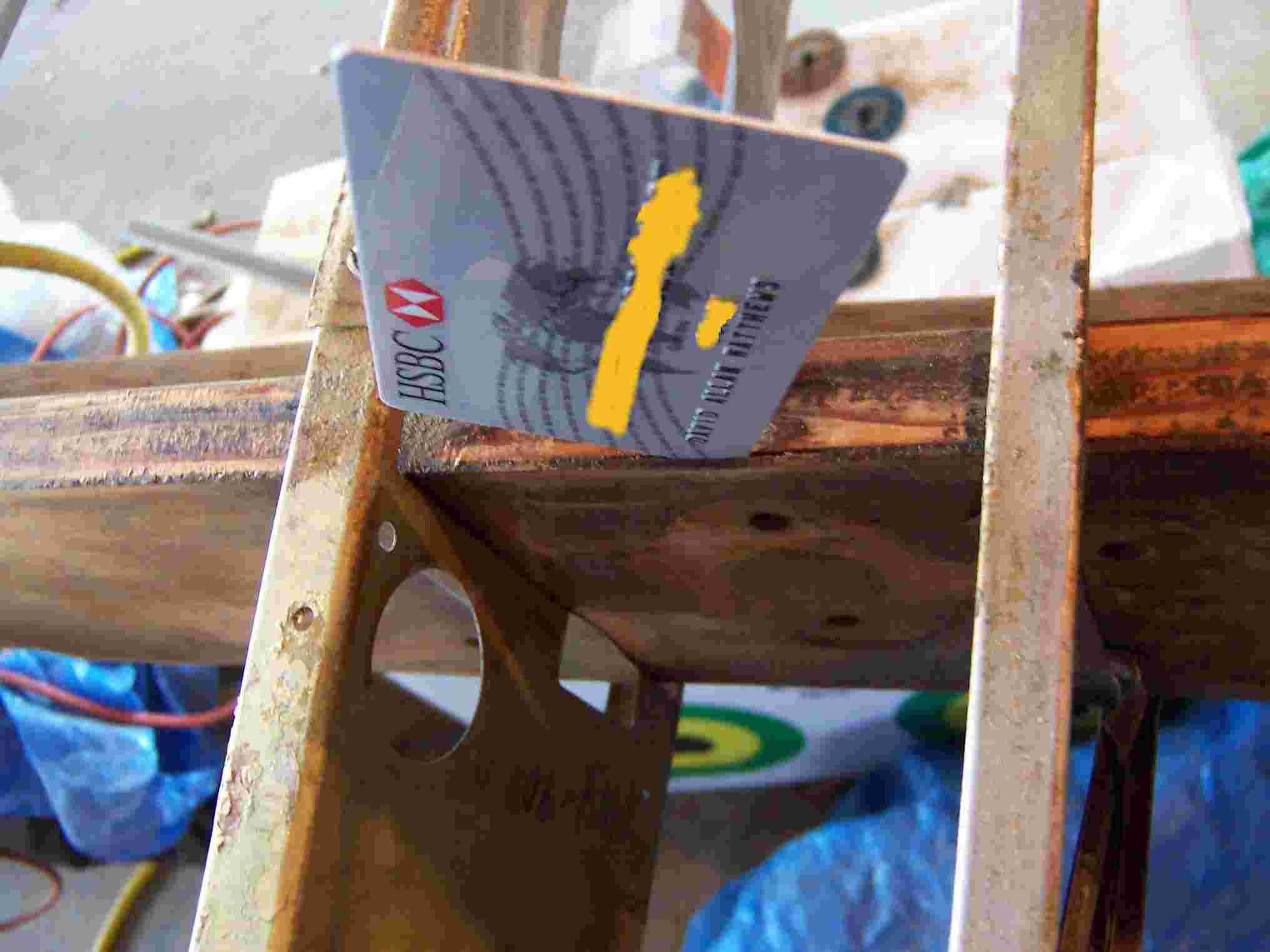

    Loose plate on the rear spar. There is a serial number plate nailed to the spar so it may have been a factory wing but the number doesn't look like the same as mine....
    Note that mix of pre and post war ribs.
    With some luck I will get the varnish on the spars and all of the steel primered on Sunday. It should be about 60 here in western NY.
