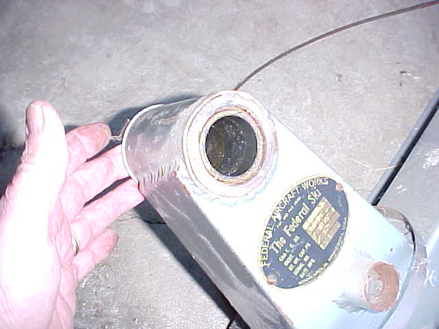

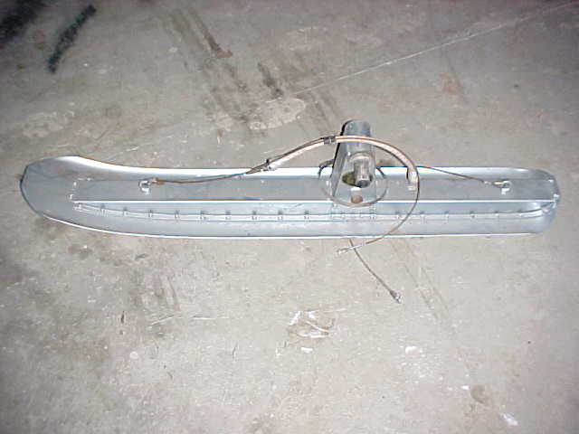

I will try to show what we are doing in NE Ohio this year. My ship is a BC12-D with Federal Ski's going on for the first time in about 6 yrs....I will make this into about three parts . First the skis themselves , then I will show them going on up in the shop. I can do this out in the cold in about 15 mins per side. I use a wing prop outside & one helper. In the shop I will use an engine hoist on the upper engine mount attach bolt on each side to lift the ship for install.
