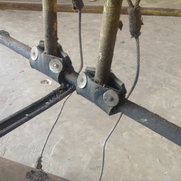

        Landing gear bumpers made from pieces cut from worn out tires.
        Cut a strip from the center of the tread. Obviously the tread is worn to onion skin on these tires...
        Work well lasts a long time.
