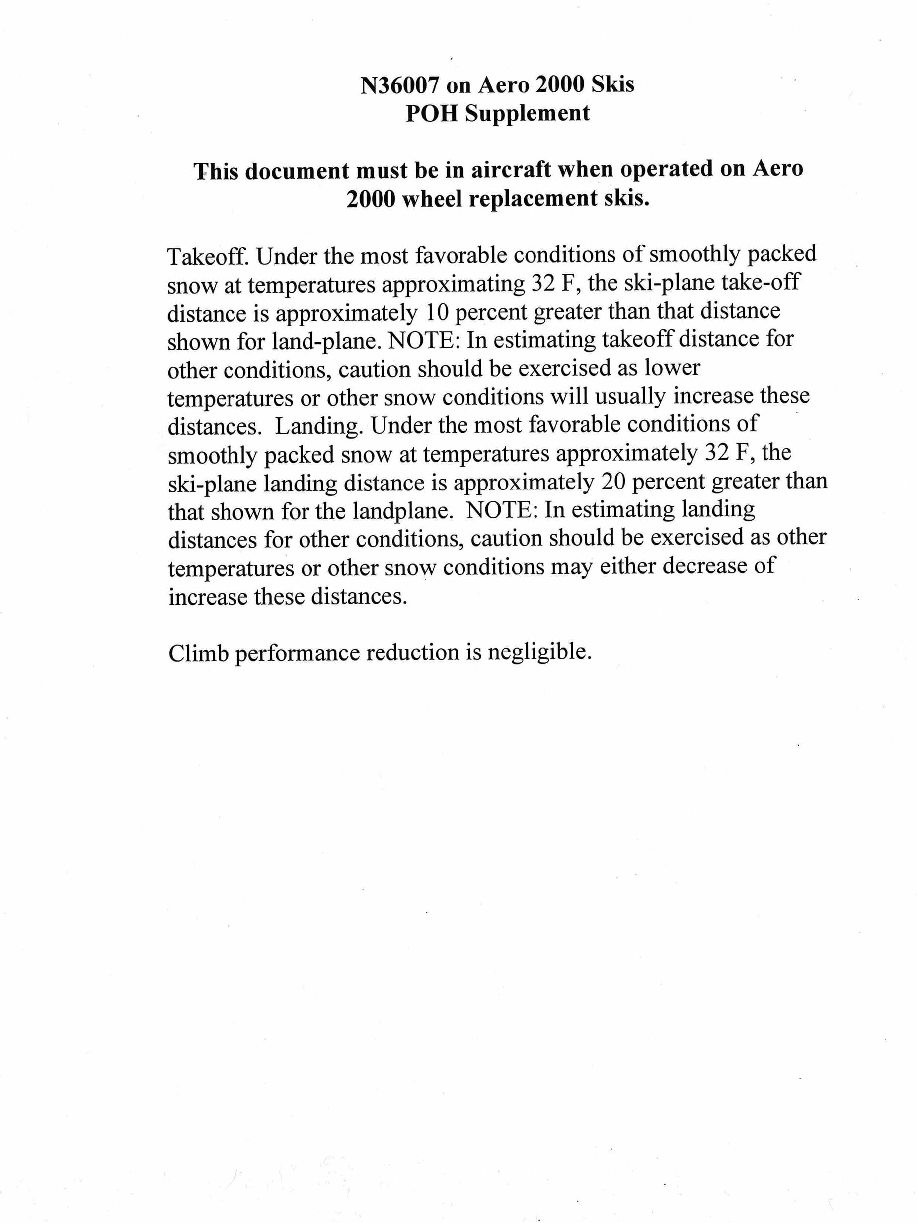

            I've had several sets new and used, but don't currently have any installation drawings except the Federal prints. Mechanics just cite AC 43.13-2B, Chapter 5 Ski Installations then the pertinent paragraphs 504-508, etc. ICA instructions are the same ref 508 (a) (b) plus CFR 43 Appendix D. W&B and equipment list revised. Plus the typical +10% and +20% performance distance increase disclaimer in takeoff and landing respectively that goes in the airplane.

              I don't remember the 10-20 factor in the 43:13 but it has been a while. I have been more focused on the gear and electrical section with this project.
                The recommended performance data change on skis is located in AC 43,13-2B Par 506. I have a copy of that and it needs to be in the aircraft FM to satisfy CAR3.
                  Tonight's read!
                    Dealers should have prints: http://www.aeroskimfg.com/aero-ski-dealers.html
                    Locally in Fairbanks Northland Aviation Services should have them. Ask for Jon the owner: https://northlandaviation.com
                      This goes in the plane
