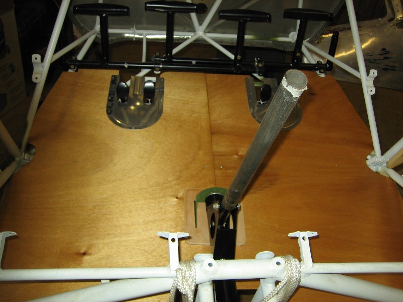

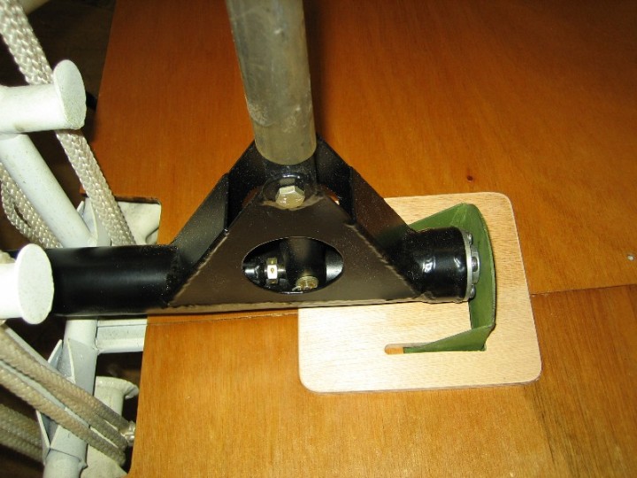

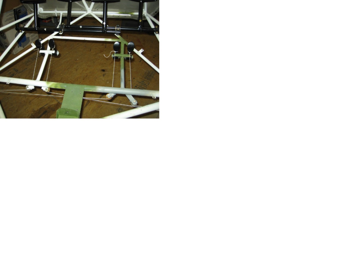

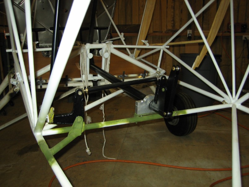

    Bad weather is good for shop time. . . . I';; try to attach some photos of my progress. . .got dual brakes in and lined up, stick is in, and floorboards are done. Now I have to finalize my plans for the doors.

    Did you use strap on bracks or weld in brackets? Looking for drawings. George

          George- I just made my own- it was really easy. The hardest part is positioning so they do not hit anything. My r/s gear leg gets rubbed by the brake lines from teh left side factory brakes. I'll have to get creative to make sure it clears with no issues. . . . I may end up welding in another pulley bracket on that side. The entire brake installation only took me a few hours.

            Thanks I was thinking of making my own. Probably weld in. George
